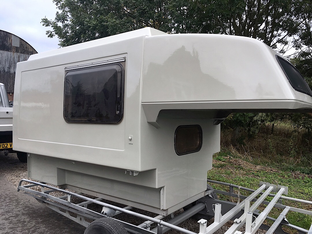

Phoenixsp1
Posts: 61
Joined: April 6th, 2015, 10:16 pm
Re: Suntrekker on T4 Double Cab project
Post: # 23787Post Phoenixsp1
October 7th, 2018, 8:56 pm
Finally painted and looks a lot tidier now, colour doesn’t look much different but it’s called light aircraft grey and looks different in the flesh. Have also colour coded the back door so it doesn’t stand out so much now. Will hopefully get more jobs done this week as ordered a few bits like new herzim strip.
wonkywheel
Posts: 481
Post: # 23788Post wonkywheel
October 7th, 2018, 10:02 pm
You have got a good gloss finish on it. I can see the house behind you in the reflection.
Well done.
