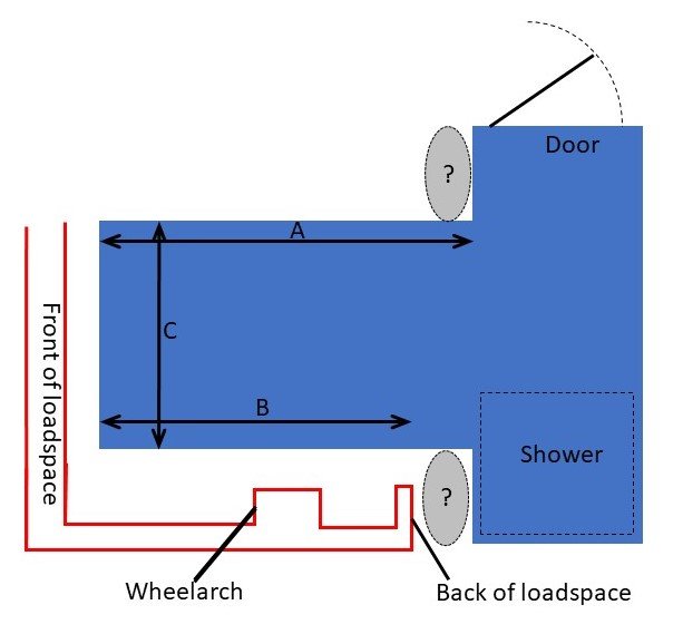

The finished truck will have a useable loadspace bed length of 2010mm, with the tailboard removed. There is no rush on this so please wait until it stops raining (??) but over the next few weeks, could a Tischer 260S owner crawl around and take some measurements? My diagram is not to scale and only half the truck bed is shown (in red). I assume there are bits of steelwork for the rear legs in the vicinity of the grey shaded oval areas and these (or any other structural parts) limit how far the cabin can slide onto the truck bed. In other words, I am guessing dimension B is less than dimension A ? Could someone let me have these dimensions and whilst you are there, also dimension C plus any photo’s that might explain what is under there that reduces dimension A down to dimension B
