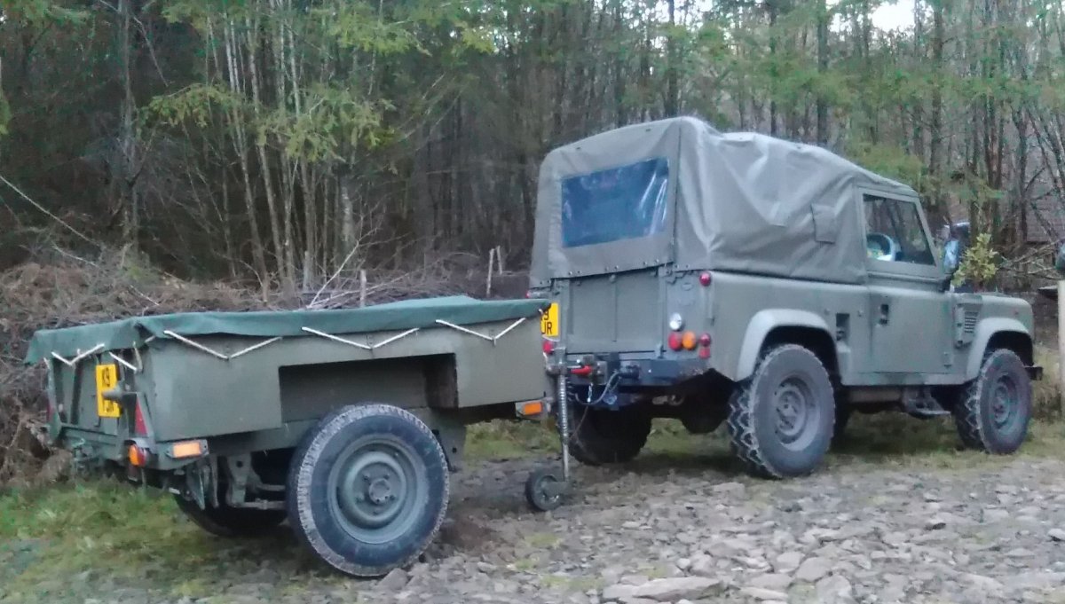

This was my old rig. A 1998 300tdi Wolf 90. I sold it recently after deciding the Isuzu ticked more boxes and only wanting to keep one vehicle. The uprated suspension on the Wolf would have been excellent for a heavier demountable though.
