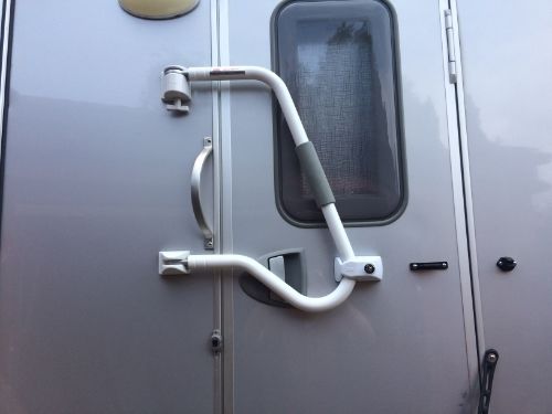

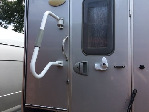

My upgrade this week is focused on some extra security. So I purchased a Fiamma Pro Security Handle 46cm from :-
http://www.fiammadepot.co.uk/fiamma-sec ... 29471.html
This was the cheapest I could find it & for what you get I think it's not bad value for money :)

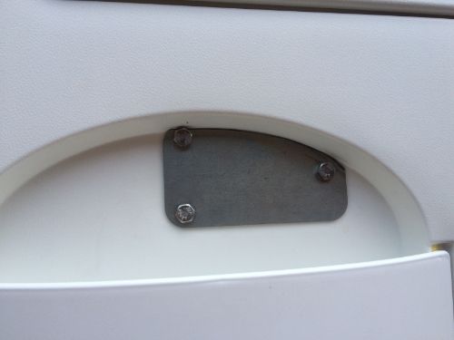

The hardest bit in the installation was the setting out, making sure that it didn't clash with the boiler or shelf in the tall locker cabinet.
Then, when I was happy with the final resting place, I set to with my trusty drill :roll:
I almost made a boo boo with the height & only just getting the lock back plate into the recess of the inside of the door. But thankfully, I had a bit of luck on my side & I got away with a bit of trimming with a hacksaw & bench grinder :lol: :lol:
So that's the next stage of my upgrades complete & I'm waiting for a couple of deliveries, hopefully this week ;) ;)
The chassis is being done tomorrow / Tuesday. So there'll be more pics & a bit of a writeup to follow soon folks :D :D

Might have to do this mod myself.
Not just security but coming down that ladder with hands full of food/wine/ageing springer has more than once come close to a comedy moment.

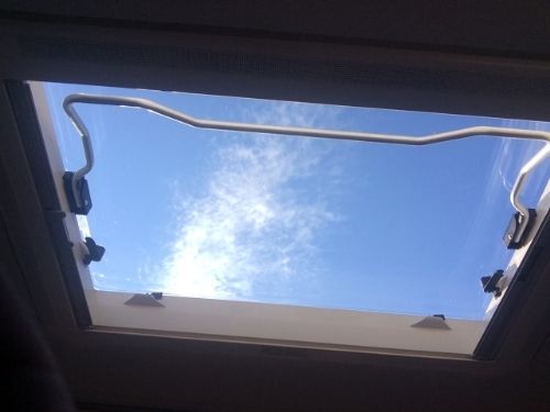

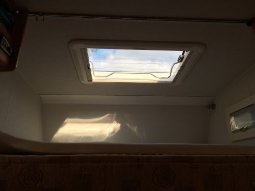

Day 3 of upgrades to the camper & we're after some more daylight. After looking around some of the rigs at the Social & thinking ours looked a bit on the dark side. I decided that it was a 'Must Have'! Ebay delivered the Heki 2 from Germany as it was about 50quid cheaper than in the UK & a week later it was here. So I set to with the trusty drill & jigsaw & Hey Presto, 2 hours later we had Light :D :D :D

out of 10, how difficult is it to do that Andy?
Peaky
Re: How have you 'improved' your camper
Post: # 7170Post Peaky
July 14th, 2015, 8:15 pm
zildjian wrote:out of 10, how difficult is it to do that Andy?
I'd say it was a 5/10 pretty easy to be honest.
It was more of a confidence thing, cutting a 960mm x 655mm hole in the roof :P :P
Just followed the instructions & before I knew it, it was all done :D :D

They are great. You will love it.
I was really nervous cutting 2 holes in the side of mine for the fridge vents. Measured 9 or 10 times for everything. Worked out ok in the end.
