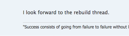

Post: # 22885Post zildjian
August 7th, 2018, 9:27 pm
See, knew he would be :)
Post: # 22887Post mjb666
August 7th, 2018, 9:32 pm
He was posting that reply as i was doing mine so that's not fair!
