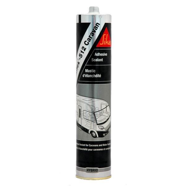

I'am going to replace a 280mm x 280mm washroom sky vent with a new item.zildjian wrote:With whatever sealant applied to underside of Skylight you choose to use (they recommend Silkaflex)
I used a double sided tape to bed it down to roof with, followed by bead of Silka round outside,
Is there a specific type of Sikaflex that i shouls use?

Re: Fitting Heki Midi skylight
Can I offer another alternative?
I found the Sikaflex 512 really good for sticking and sealing but, if at a later date the item needs removing. You have a problem separating them again.
On "Lightning" the roof vent was fitted with a roll of mastic.
It comes on a roll, a bit like double sided tape, but is, and remains, pliable. It has the consistency of a sticky putty so will squeeze into place when compressed. That was fine for my vent as when the screws were tightened I got a perfect seal. Also, 5 years later I was able to slide a pallet knife into the joint and remove the vent to put into the new build
I got mine from White Arches caravans in Rushden. This is the original box as the roll is 5 meters long and costs £9.64 back then, and I will be using it on the new build (no shelf life constraints)
Mark
Mark
Thanks Zildjian & Mark
A practical Mate, who will be supervising my sky vent install, has used this sealant, similar price to Sikaflex 512 & reckons it's better, thoughts?
https://www.ebay.co.uk/itm/Non-drying-B ... Sw34FVE8lB
"NON DRYING BEDDING SEALANT
USED BY THE EXPERTS OF CARAVAN MANUFACTURE
WE HIGHLY RECOMMEND THIS PRODUCT IF REPLACING OR RESEALING A SKYLIGHT"
I can get the W4 Mastic Sealing Strip, again, about the same price but have discounted using it as i hope never to have to remove the new sky vent or is this short sighted? And is it easier to work with?
