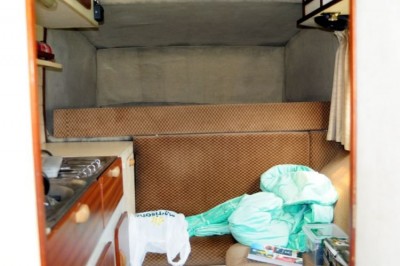

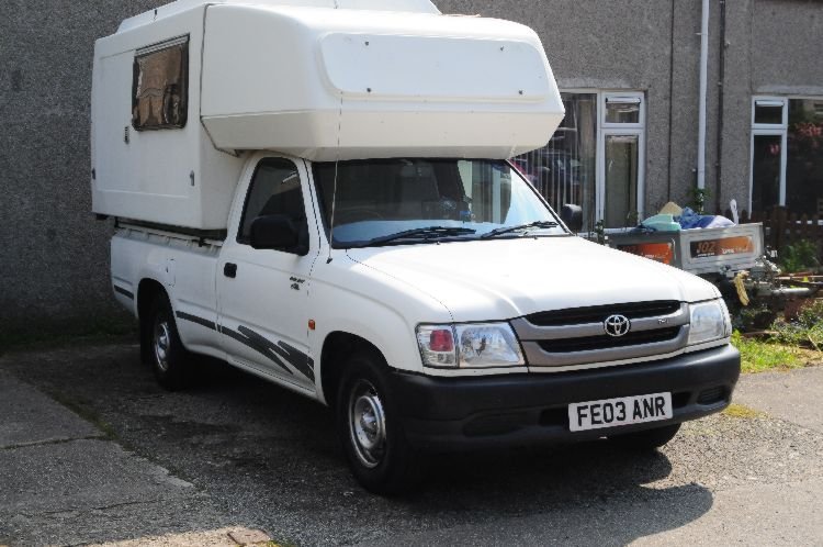

Not the same one Amanda - this was bought as a shell from IP and fitted out for 2 people long term wild camping - on the inside along the blank side (where one of your bunk / side settee is) there is a quite spacious Kitchen area at the rear (where your galley is) there is a wet room shower and space for the loo - on the other side ( where the kitchen is), there is a window and an L shaped seating area.
Excuse the untidyness of the interior - and please no one tell my Sandra that I posted the picture. she would kill me for showing the interior not looking spick and span :roll:
