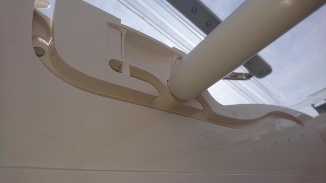

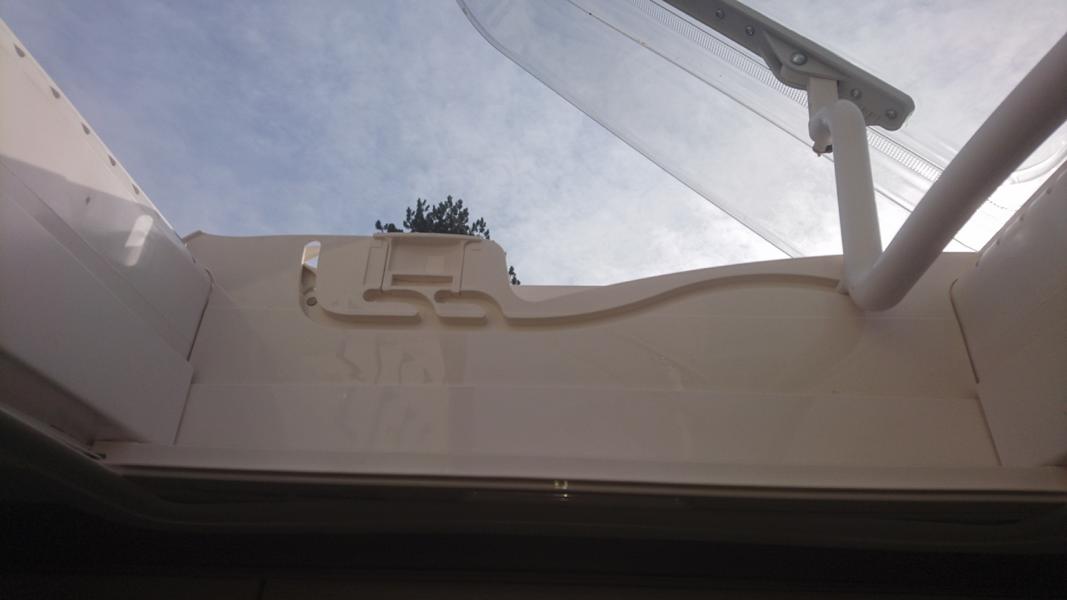

At first... nice work with this window. But may i give you a hint?
We have the same windows on our van and when its open it may flap over when the wind is blowing.
Heki (Dometic) offers a simple thing to fix the hood in half opened position.
It's not very expensive and will be mounted in an half hour. It works very well!
https://www.campingplus.de/Ersatzteile/ ... gI3SfD_BwE
Perhaps it is available in GB too?!

Hello again & thanks,
after I'd fitted the Heki I did actually wonder what kept it securely open, when you have time could you take a picture of your locking kit installed
I've had a quick look for a 'Heki midi locking kit' but so far not seen one on sale here

Right, so not found any reference in UK to this upgrade
does kit comprise of same item both sides of skylight?

Yes, this is for both sides. One left, and one right. Mirror...
You have to replace the original sideparts.
You can 'park' the roof in two different positions. And, as said before, the installation is a thing of an half an hour...
