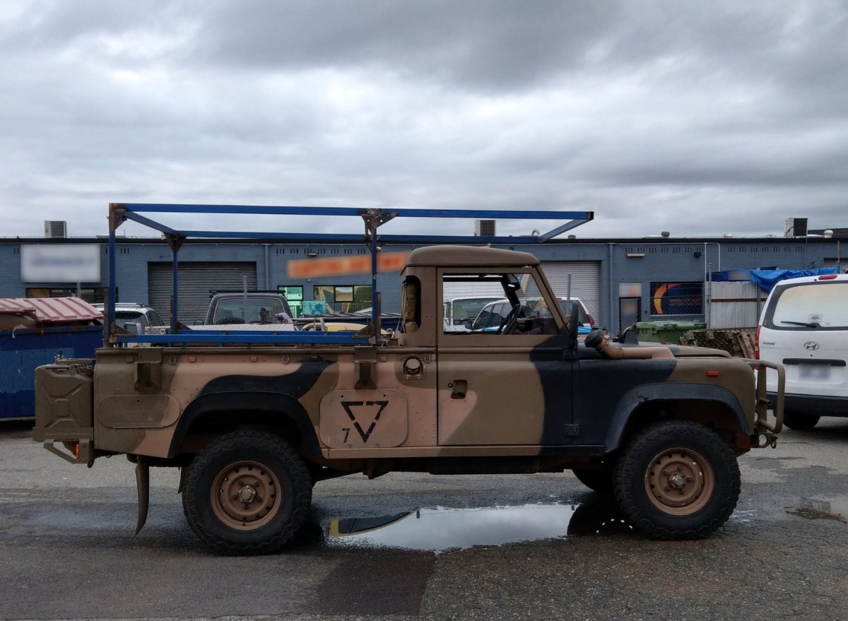

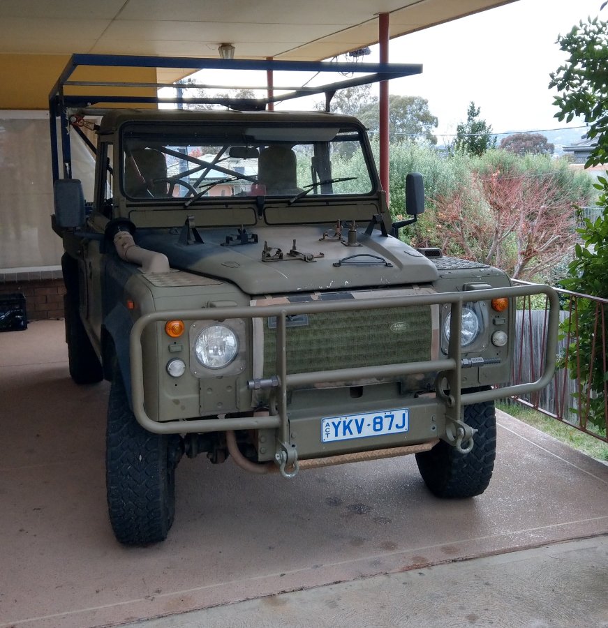

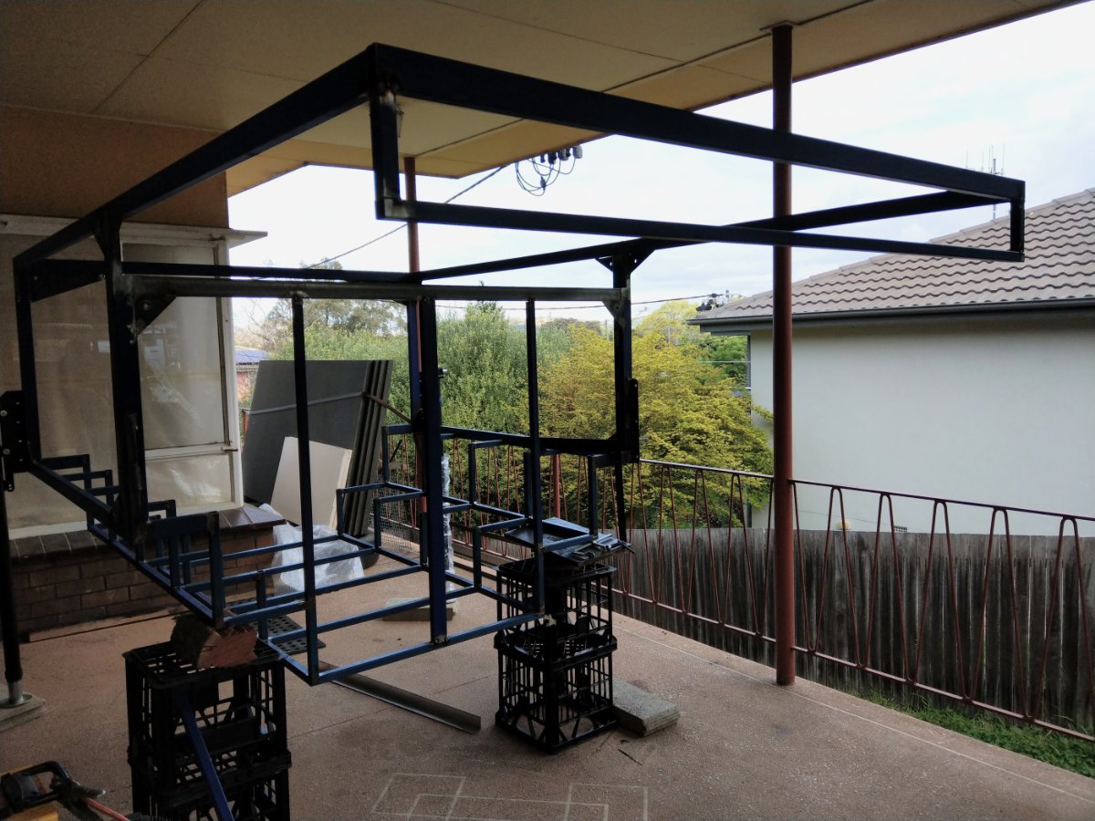

Well, the exoskeleton is here at home now for paint and prepping before the flashing set up. Yesterday it was another afternoon of "final touches" at the welder yard ....with threatening weather and pretty cool winter air the whole time. Not having cab windows as yet (parts lost in transit?) i had visions of getting soaked or frozen by sleet. I drove home at last light, after helping pack up gear and lock up, wearing gloves and a parka.
I have lived here 14yrs and seen snow on the hilltops most winters but never in the streets. Could happen if we get Antartic systems work themselves any further north. I don't think painting in these cold temps is practical :) so it will just sit there a while. But I will trial fit the Reico legs tomorrow. Also i will hit the weighbridge next week to get a figure on the exoskeleton.

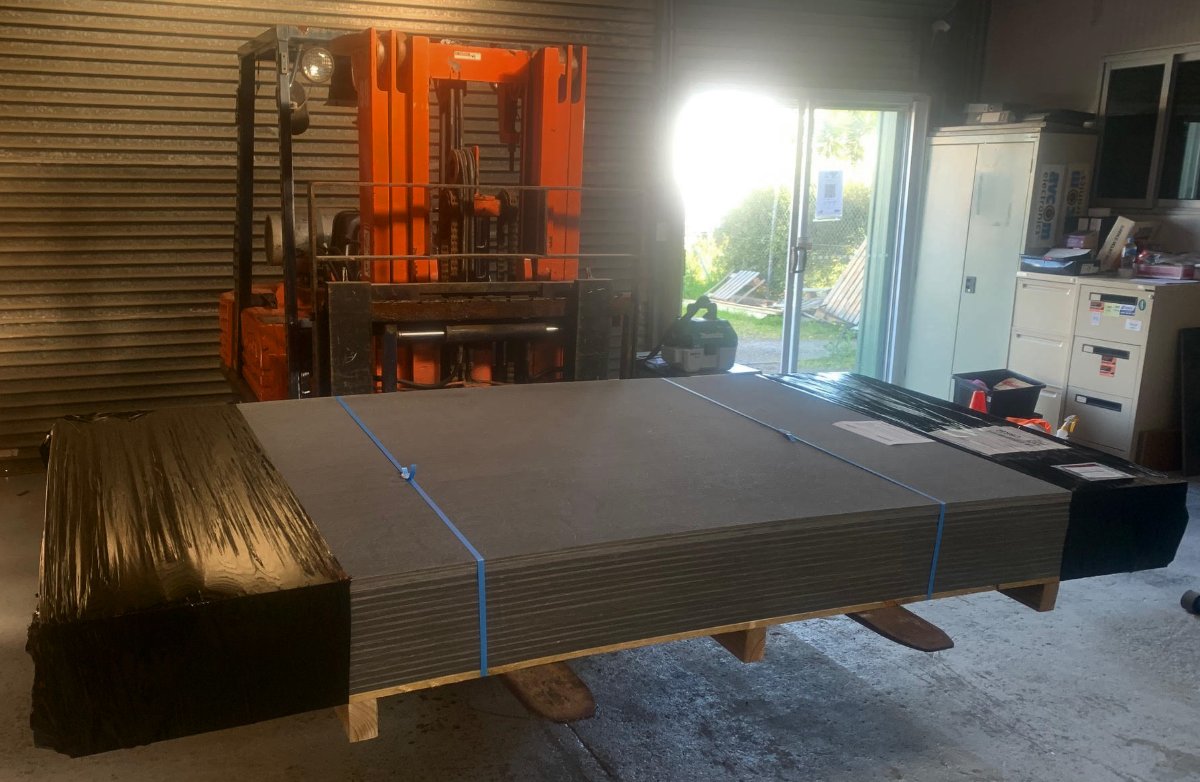

The panel supplier sent a pic of the shipment.
There are double or more than what one bivbox would need.. but at the current way things are going with inflation i'd rather have them up here. I may end up making a box out of a trailer as well.

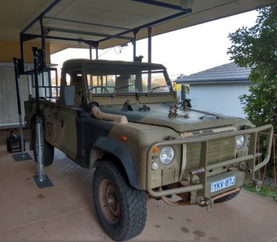

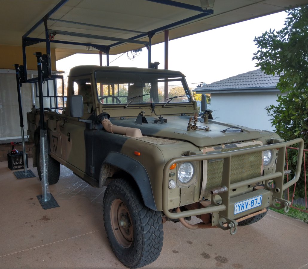

I tested the legs out to their max lift. What i discovered is that the shelter ceiling is too low. I will use the spot to cut, rout, glue, screw and paint the build. After its built I will have to roll the bivbox out from under the ceiling to lift it up and fit it in the Landy.
To be able to roll it at all i will have to come up with castor wheels under the legs or somesuch.

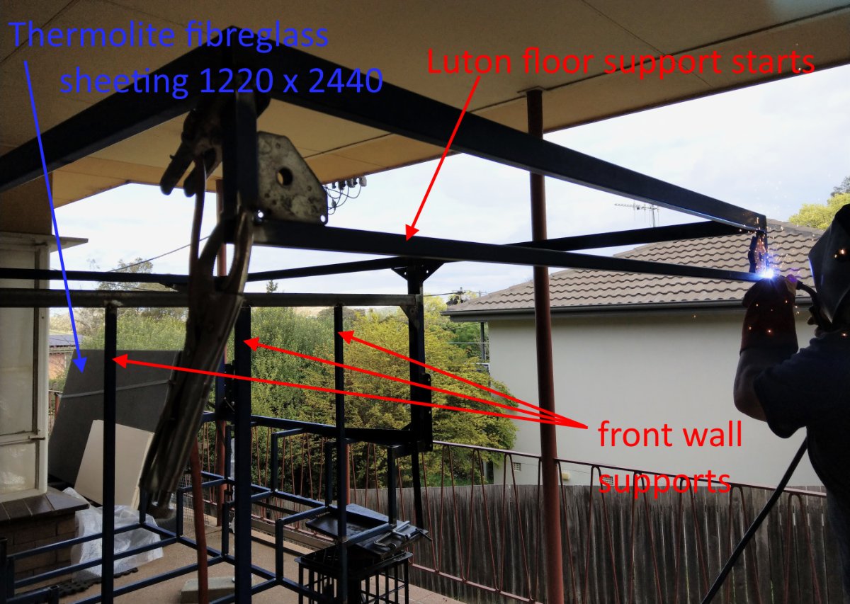

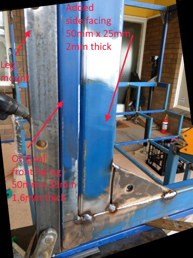

This last week i got home and my good friend WT assessed the bivbox frame and drawings etc and offerred to assist in a big way - finally, a payoff to living in a 8wk lockdown (in reality a lockup).
WT saw a stress point in the mid uprights, stress from the Luton weight, and that it could let go when in sand track "moguls". So some thicker reinforcement in order there.
Also, we ran through a trial and error with the sheet panelling and discovered the hassles of fitting/sealing 3 way corners inside a framework.. short version is that to speed up the build we will clad the outside of the frame (from above the waistline), after some extra steel verticals are fitted. These verticals can hold track (or anchor bolts) for interior cargo and exterior cargo. We plan on using nutserts aka rivnuts.

Also after some supervision I am doing basic mig welds myself, after some lessons and practice from WT. This is a positive outcome from being locked up for 8 weeks and being in a single location "bubble" at work, albeit with loss of some shifts/ loss of income..
The extra steel frame work so far weighs 27.3kg according to the spreadsheet. I intend adding another floor bearer 25mm x 25mm to help prevent hollows or dips developing in the floor panel due to the possible cargo carried. The fridge is to be on that floor, its portable, but relatively heavy, living inside on the floor but also being taken outside at some camps. The extra width of the rear hatch design/do-over will aid that convenience.
Yesterday the framework of the rear hatch was sized up and fitted using a few taped on keys (could not find enough coins) 3mm thick (and magnets) to get the frame positioned correctly before tack welding. The result was pleasing. A door seal is ordered and the backplate that functions to hold the seal and struts in place under compression be a door stop (whatever its called) and the strut mounts, is also in our minds too. That part will be a total trial and error using 50mm width stainless plate cut to length.
