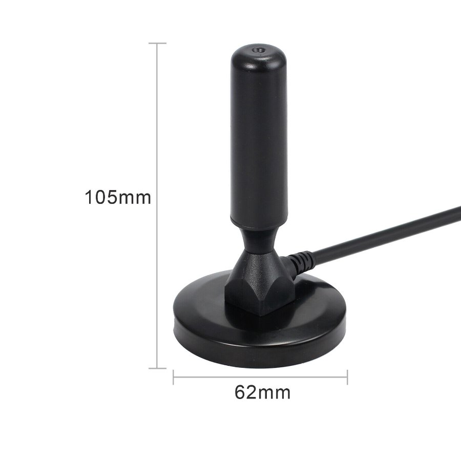

I bought one of these aerial's, works great, has a magnetic base which would have placed on roof by poking out through skylight
except of course roof is aluminium
https://www.ebay.co.uk/itm/204043908134 ... BMvNam6oBi
which I'd not actually considered at point of purchase

Thanks Zildjian,
That looks just the job, Ill order one of those. I should be able to ease the inner ceiling skin away and put a metal plate under the fiberglass for it to stick to..
Mine might have to have the lead out a side window as my roof light has an electric fan and a fly grill.

Tried using inside but like a mifi or phone, the aluminium body doesn't allow that so well so it
went out through skylight,
No direction needed, and works a lot easier than the satellite dish i installed at start, I'd remove it but then I'd need to plug the hole it passes through in roof to direction disk on ceiling
