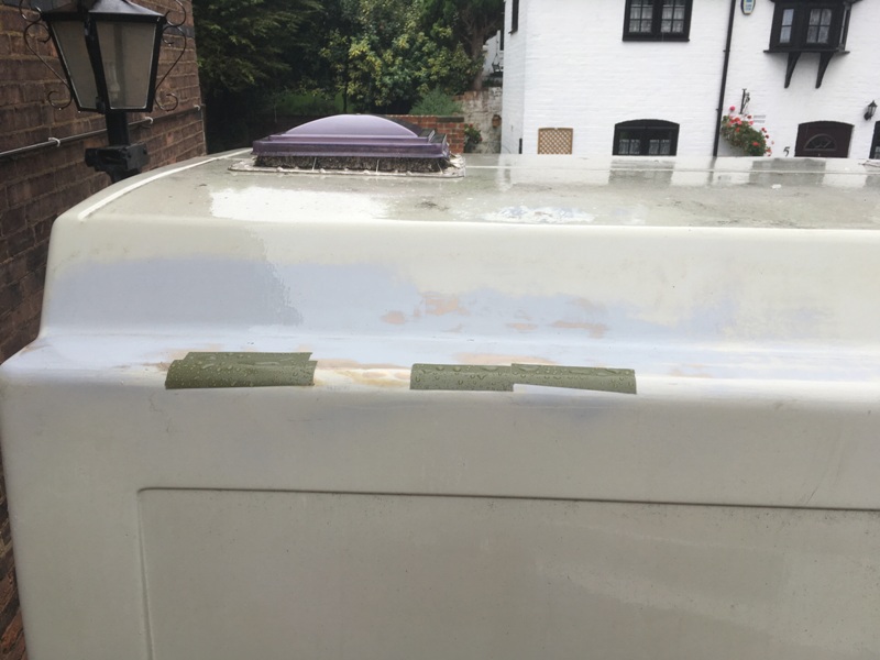

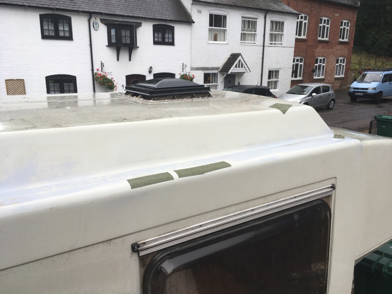

Why paint it? Mine’s not painted, just the original gel coat. It was a built dull and chalky, and I’d thought of getting it resprayed, but then I remembered that years ago, a body shop guy had suggested that a machine polish all over would bring it up like new. So I bought an orbital polishing machine and a set of cutting and polishing compounds. A few hours’ work later, it has come up like new. Unless you really want it a different colour, machine-cut-and-polish may do the doing.
