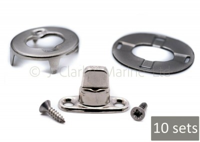

This afternoon we went shopping at the canvas shop. We look at the various clips and methods but eventually decided to use shock cord in the hems and clips in the hatch frame for the cord. Its what we had in the previous (original) Landy canopy at that end.

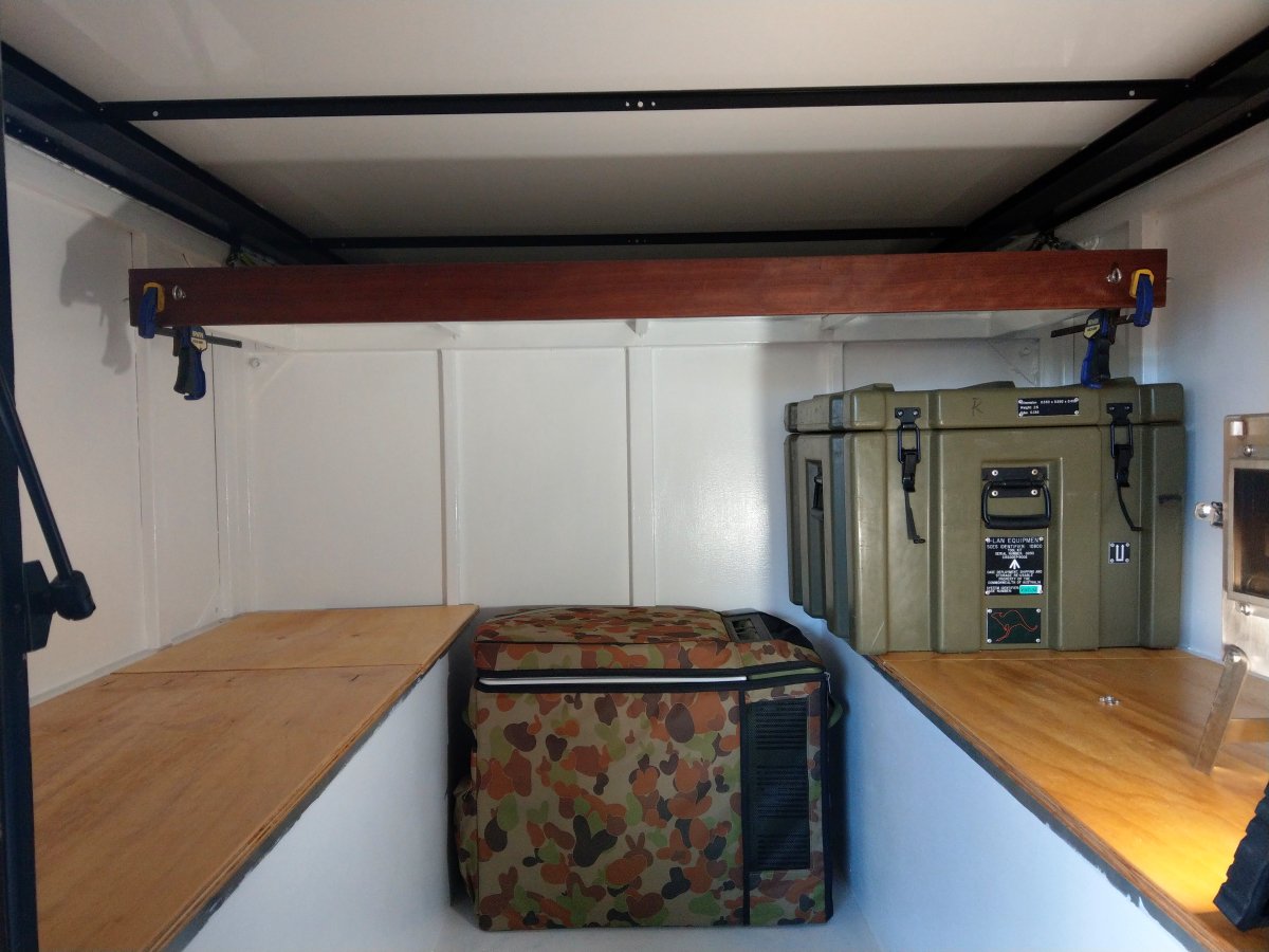

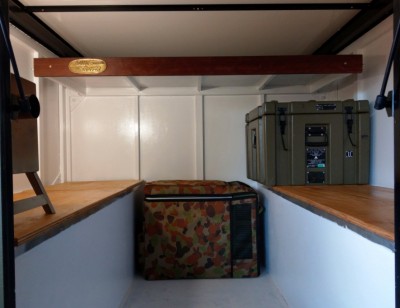

I went over to our gear stash container and brought home some cargo items to test fit. Also managed a tiny job working up a bit of hardwood trim. It began as a template of the final trim but time is too short.
I have to do some M6 rivnuts and eyebolts around the steelwork to provide strongpoints to be able to secure cargo.
I would like to make a 1600 long 18mm thick benchseat back support along the sides. When travelling this backboard could cover over the Fridge in the middle floor and allow cargo to be stacked all the way across the bulkhead in the area below "the windscreen" and above the fridge. Fridge is an Engel 40litre with a top opening lid.
