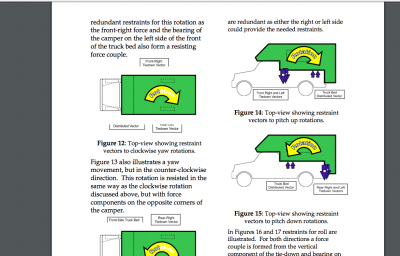

is it just the case they are immediately below the corresponding hooks on underside of camper
or
does it make a positive difference if they are slightly forward of the camper
{so pulling forward so to speak}

I've always assumed that pulling slightly forward and outward was the ideal - if possible.Ogden scamper wrote:Eyebolts
or
if i am over-thinking this somebody please say
If you think you're over-thinking it, you should check out this guy!
