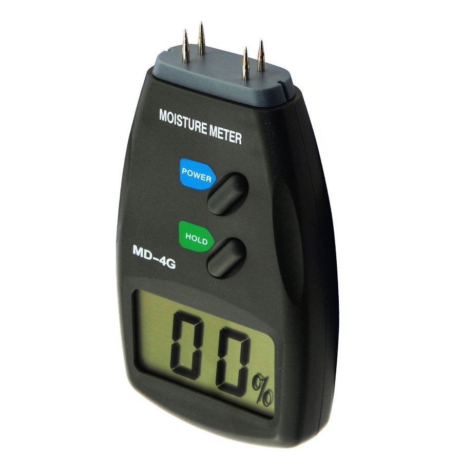

When buying any used camper we always recommend taking along a damp meter these are cheaply available from Ebay and simple to use and can save you a lot of money and act as a bargaining tool.£8.79
Try everything electrical you can, ask about heating and water systems, and decide if its been lucky enough to enjoy winter storage out of the elements or has been damaged in the past
Body: As with all timber framed campers moisture in the structure is the biggest nightmare. It's unlikely to be an issue unless the unit has been damaged, but as water likes to track everywhere even a little damage can cause big problems over time if left unchecked. Checking with a moisture meter (from the inside) should be considered obligatory. If the van has a shower compartment pay particular attention to this area.
