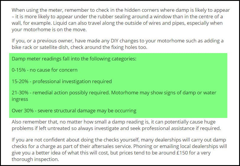

These are the figures you should expect to see when you lightly push the damp meter prongs into interior wall of a camper
