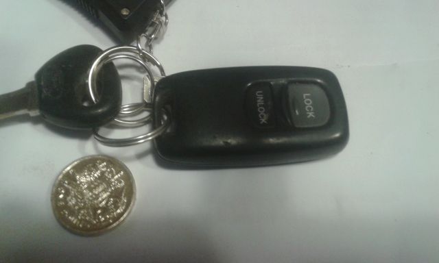

Did you notice anything like a security (aftermarket) security device I'm guessing it probably has some sort of key fob wih it,
not heard of anything in binacle area till now is all
Re: Ranger gauges not working
This is my key and fob . The key will open everything , the fob isn't really necessary . Apparently the key is also weird and most a auto lock smiths can't get the chipped blanks at a reasonable price . The cheapest I have seen is £75 , but that is up north somewhere.
I have no extra alarms , I think my man was Checking mine wasn't the 2006 + model with the dash/ immobiliser system , but I might have that wrong .
