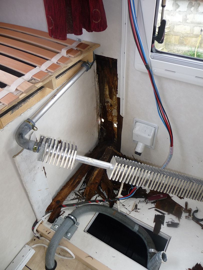

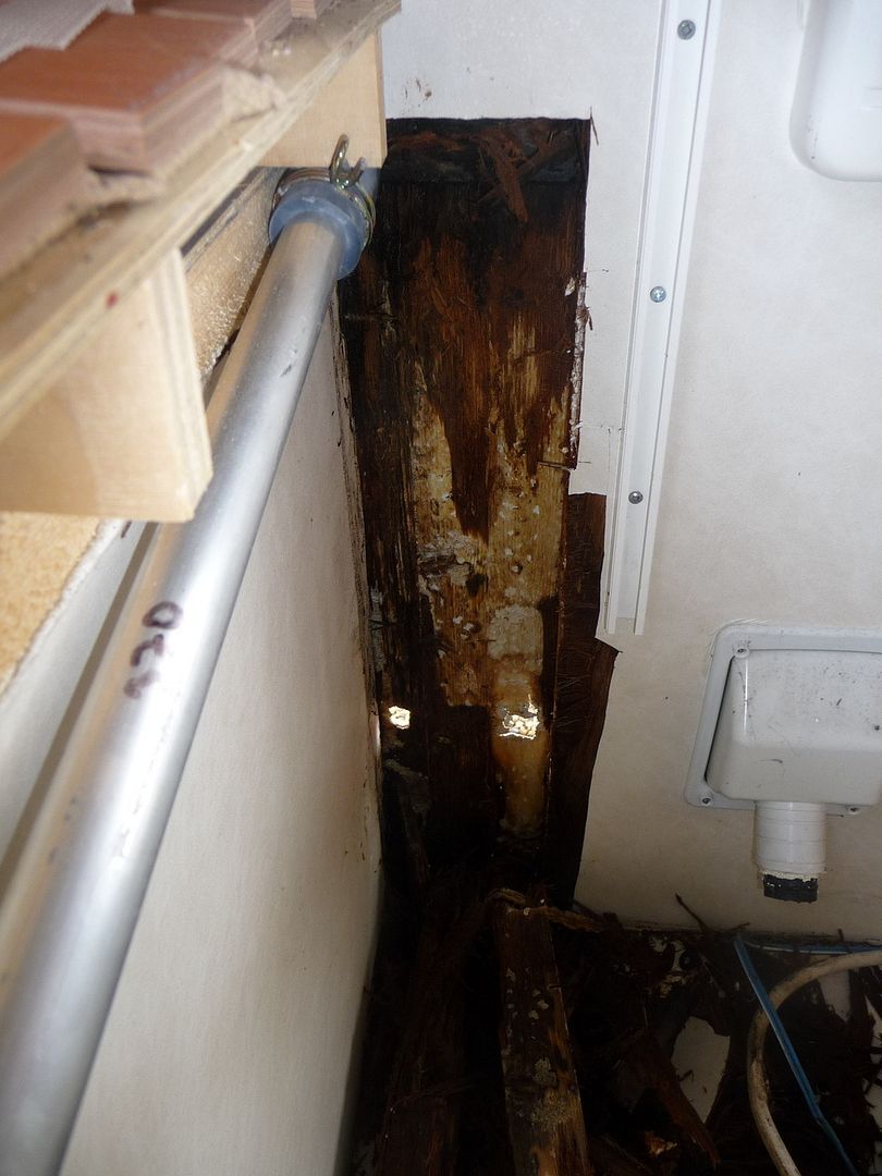

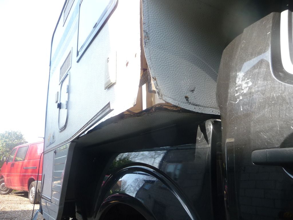

The mount for one of my front legs was a bit wobbly so I sent it to my tame fabricator to beef up a bit, and this is the email he sent me after he'd looked at it:-
OK so the not so great news, after removing the RH front leg mount it became clear why it was struggling to do it's job. There is a leak that has gone unnoticed for some considerable time which has caused all of the wooden structure in that corner to rot away (see photos). The vinyl lining on the inside and the aluminium on the outside covered the problem so there was very little evidence what was going on out of sight and the water could not escape. There were pieces of timber sandwiched in the structure to reinforce it around the mount. I have removed all of the rotted wood in the area and will replace it and bond/screw it all back together. So basically I am making progress but the job is a bit bigger than hoped.

That's worrying, from the experience of SKarosser owners compared to other makes, these seemed to be the one that didn't suffer from water ingress. Maybe we should look at one of the pro damp meters the dealers use.
The water fill point is in that corner isn't it?, wonder if a failed seal there could be the culprit?

Looking again at pictures though I notice the filler inlet to freshwater tank appears much lower than the wet-damaged area,
Ingress must surely have been either at the mounting bracket or above it,
and your man mentions glue+ bond that area only so I suppose that likely means the bracket fixings really.
Guessing only but if it had been loose for awhile, following a knock or something, water might get in through unsealed bolt holes and exacerbate it till it became 'wobbly'
either way fortunate (if that's the term) you found out at home.

zildjian wrote:Looking again at pictures though I notice the filler inlet to freshwater tank appears much lower than the wet-damaged area,
You'll notice that the water hose has been unclipped from it's normal position. This is due to the clean strap marks on the hose. It has then been pushed through the anchor point access hole temporarily. The leak may have been around the filler cap, as we all just leave the hose pipe wedged in & running :?
