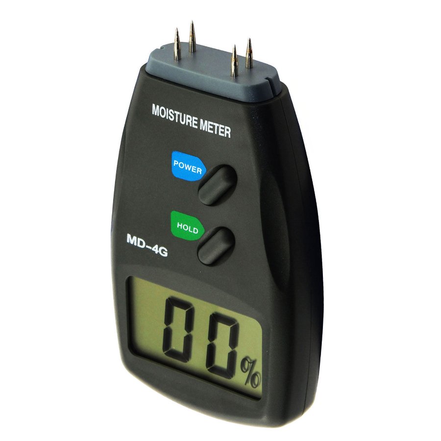

When buying any used camper we always recommend taking along a damp meter these are cheaply available from Ebay and simple to use and can save you a lot of money and act as a bargaining tool.

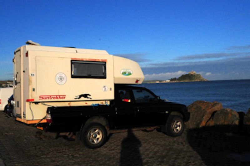

Hi bit belated @Amanda_P re replacement windows. The original side window in ours was getting old - curtains needed replaced etc. (as I have said before our one-off unit only had a right hand window when we got it - I had already fitted a small Seitz copy Shield window in the LH side)
So I bit the financial bullet and bought a 1000mm x 450mm Seitz S4 window from Grasshopper Leisure - not cheap but during lockdown we blew the away budget on upgrading.
https://www.grasshopperleisure.co.uk/do ... -106-c.asp
Here is a picture - it still needs a little finishing but I think it looks good and we do find the blinds solve a lot of problems. Total upgrades in addition to windows are new kitchen (sink 2 burner hob), MaxAir Heiki type rooflight, and we made a boob a new Propex HS2000 blown gas heater

Was it complicated to fit?
couple of years back I fitted a sunroof and found that really straightforward
(apart from the initial trepidation of cutting hole in perfectly good roof) :)

You know the old saying "Fools rush in where Angels .....etc"
Well I rushed in (I have already converted old type roof lights to Mini-Heiki) so like you, I have had some experience.
All I had to do ws use the bottom and front edge of the apperture as the reference points - if I recall correctly the apperture needed opening heightways by about 5mm and a shave on the length.
The first step was to remove the curved ends - the radius is too big.
Once the apperture is right it is as simple as fitting a rooflight.
If I had been working in a barn I could have made good the GRP over the window - in my case as I am working on a sloping driveway (SPLATT in Cornish) it remains on the to do list - next week maybe! "Dreckly" in Cornish. If you want to understand "Dreckly" think Mananna in Spain :D
two handed it is simple to fit - coat the inside of the outer frame in a lot of sealant (never skimp) - helper pushes and holds outer window in place - expert (moi or you) Places inner in place and begins to tighten the screws.
Work diagonally from centre ut to avoid warping!
(At some point the helper will wail "I am bored, or Do you really need me?" - you may at this point think of other uses for sealant (only joking ;) -
But yes it is very simple YOU JUST HAVE TO BE BOLD AND MAKE THE FIRST CUT!!!
