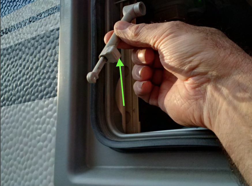

'Kitchen' window stay,
stopped holding window open, removed it and looked,
In the picture below my thumb is a little spring clip in grey plastic, remove that to reveal a tiny spring with a ball bearing beneath it that bears down onto the sliding ram inside and locates in three shallow holes which holds window
closed>open>open more>fully open,
a spring out of retractable pen, tiny bead from some a broken bracelet and its fixed
saDgit
Posts: 336
Re: Something to report !
Post: # 13526Post saDgit
June 6th, 2016, 8:27 pm
zildjian wrote:'Kitchen' window stay,
A small cable tie around the grey plastic spring clip stops it from happening again.

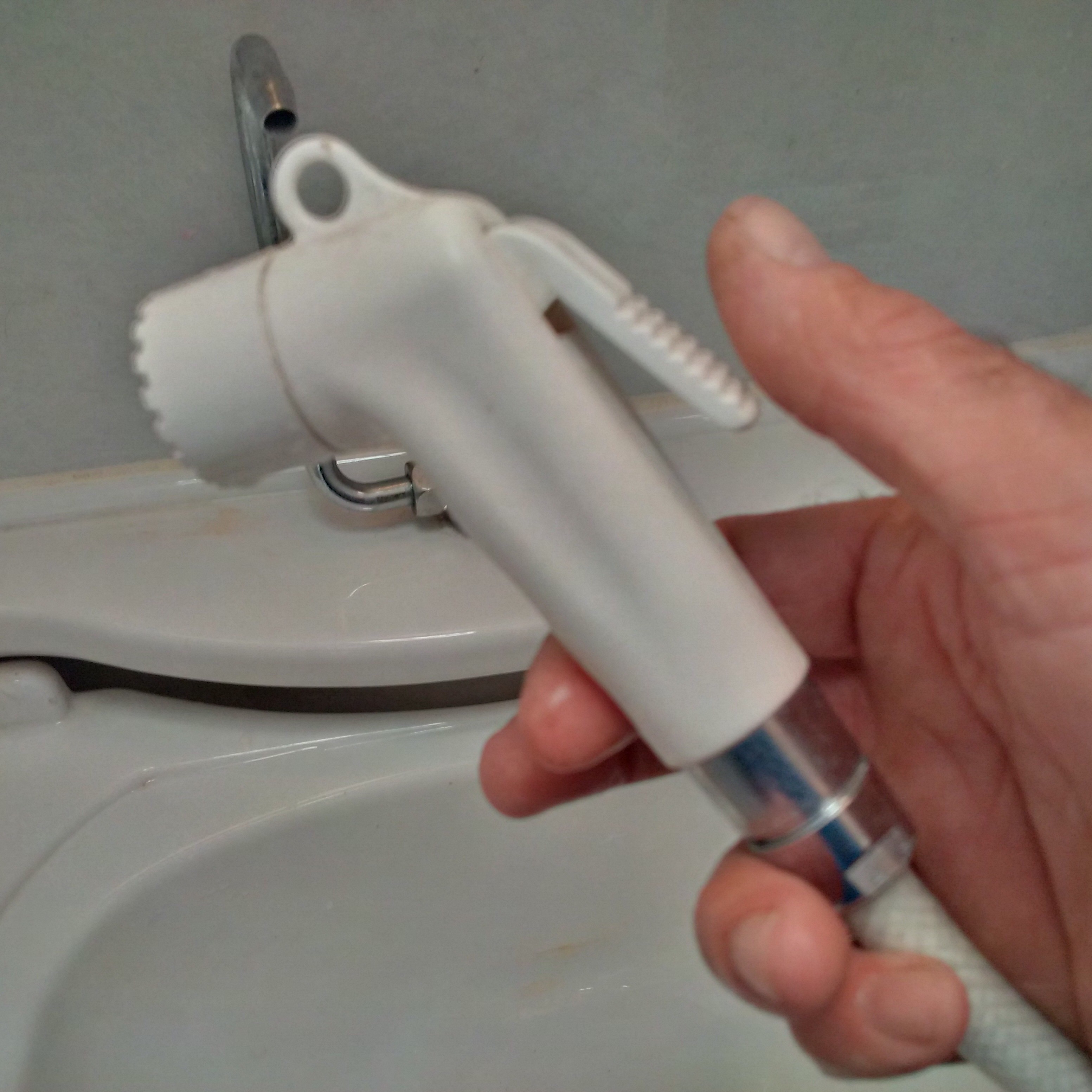

Little thing this time;
Shower head, discovered a small puddle of water in shower tray this morning, imagined it might be the Thetford toilet flush tank (not quite sure why) and had look but saw nothing untoward,
finally tracked a small water seep from shower head trigger thing,
only ever tried tried shower once in all the time I've owned it and gave up immediately as it meant refilling fresh water tank!

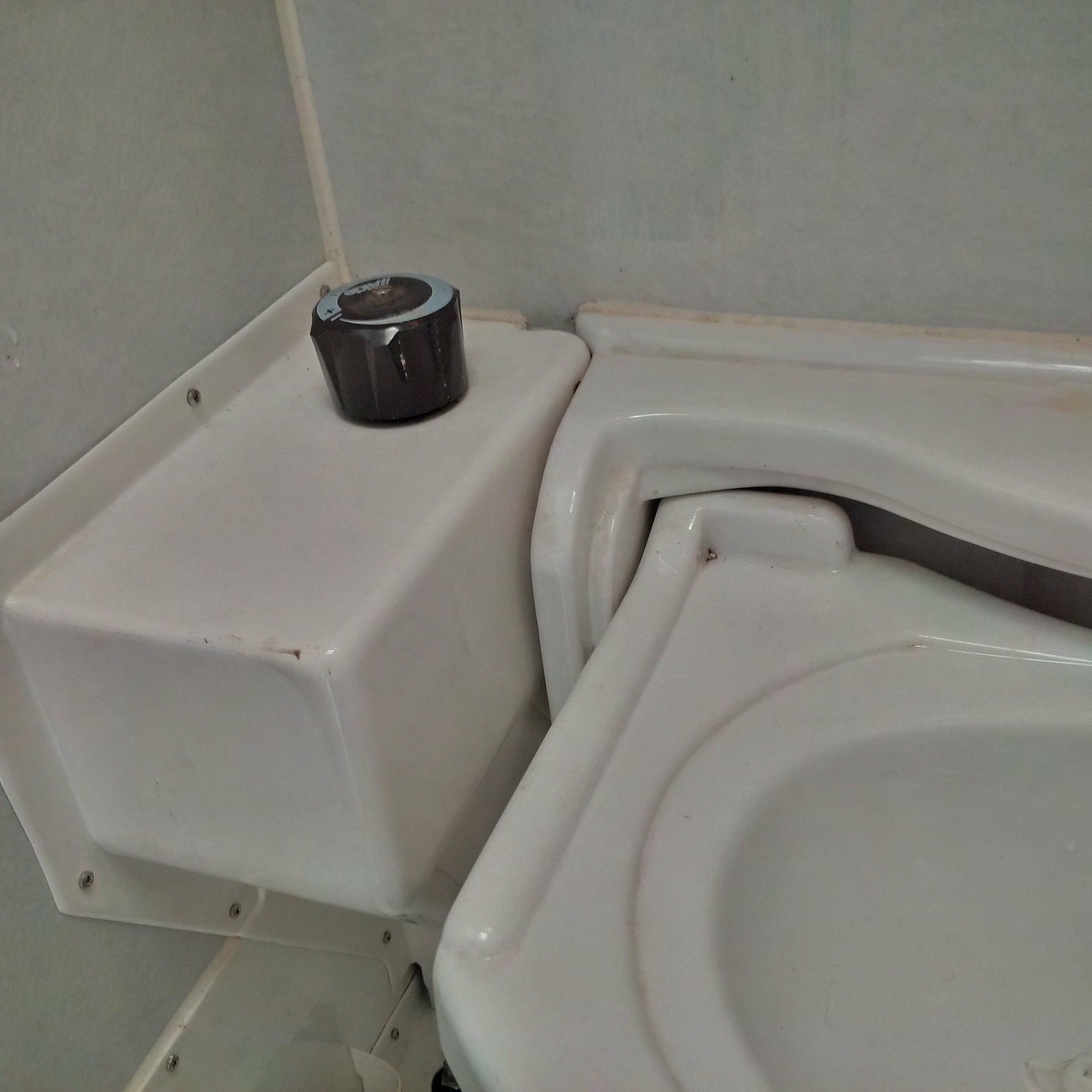

and the control beside sink I always imagined to be a tap (and so probably OFF) is in fact likely a temperature control,
meaning shower is permanently under pressure.
Next week when I get back I'll either remove and cap it off depending on access, or repair or replace shower head although we never use it
